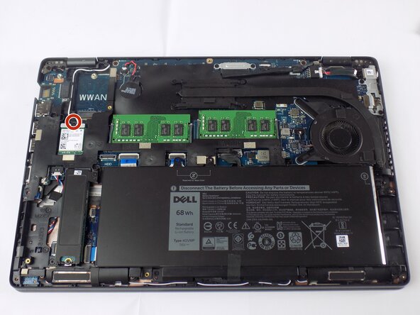

    1. Dell Latitude 5400 Wi-Fi Card Replacement, Wi-Fi Card: step 2, image 1 of 2 Dell Latitude 5400 Wi-Fi Card Replacement, Wi-Fi Card: step 2, image 2 of 2
      • Remove the single screw that is securing the Wi-Fi card.

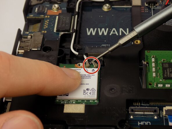

    2. Dell Latitude 5400 Wi-Fi Card Replacement: step 3, image 1 of 1
      • Remove the two antenna cables from the card.
      • Take note of which slot each wire fits into. You will need to match this when reinstalling your card.
