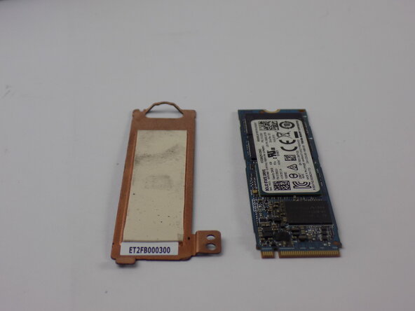

    3. Dell Latitude 5400 SSD Replacement: step 4, image 1 of 1
      • Separate the SSD from the metal heat sink.
