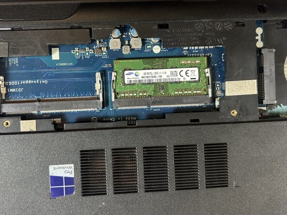

  3. Dell Latitude 3540 Ram Replacement: step 3, image 1 of 1
    • 3. Locate the RAM Look for a small rectangular stick (or two) It’s held in by metal clips on each side
    Ask FixBot
  4. Dell Latitude 3540 Ram Replacement: step 4, image 1 of 3 Dell Latitude 3540 Ram Replacement: step 4, image 2 of 3 Dell Latitude 3540 Ram Replacement: step 4, image 3 of 3
    • 4. Remove the RAM (if replacing or reseating) Gently push the clips outward The RAM will pop up at an angle (~30°) Slide it out carefully
