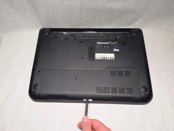

      • Slide the battery latches outwards in opposite directions.
      • Remove the battery from the device.

    2. Dell Latitude 3440 HDD Replacement: step 3, image 1 of 2 Dell Latitude 3440 HDD Replacement: step 3, image 2 of 2
      • Remove the single 4.7mm screw from the access panel using a Phillips #1 screwdriver.
      • Remove the panel.

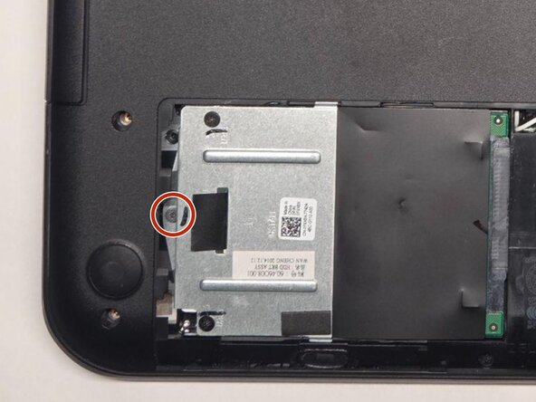

    3. Dell Latitude 3440 HDD Replacement: step 4, image 1 of 2 Dell Latitude 3440 HDD Replacement: step 4, image 2 of 2
      • Remove the single 2.9mm screw from the hard drive using a Phillips #1 screwdriver.

    4. Dell Latitude 3440 HDD Replacement: step 5, image 1 of 2 Dell Latitude 3440 HDD Replacement: step 5, image 2 of 2
      • Slide the hard drive out of the slot to disconnect it from the connectors.
      • Lift the tab to remove the HDD from the computer.
