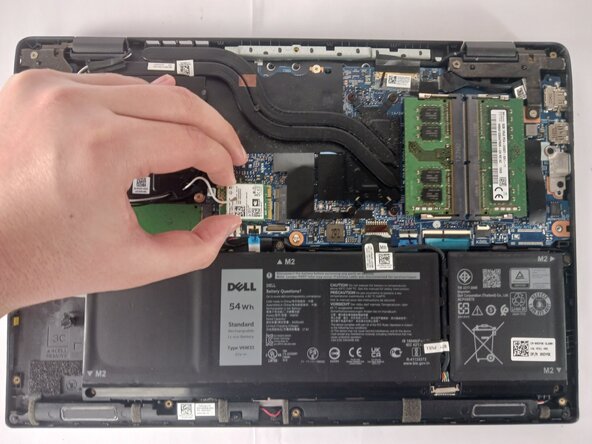

    1. Dell Latitude 3420 Wi-Fi Card Replacement, Wi-Fi Card: step 6, image 1 of 1
      • Remove the single 3 mm-long Phillips #00 screwdriver securing the Wi-Fi card.
      Ask FixBot
    2. Dell Latitude 3420 Wi-Fi Card Replacement: step 7, image 1 of 3 Dell Latitude 3420 Wi-Fi Card Replacement: step 7, image 2 of 3 Dell Latitude 3420 Wi-Fi Card Replacement: step 7, image 3 of 3
      • Use the tip of a spudger to pry up and disconnect the two Wi-Fi card coaxial cables.
      • Pull the Wi-Fi card directly out of its socket.
      Ask FixBot
