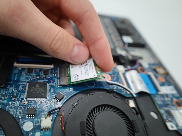

    2. Dell Latitude 3310 Wi-Fi Card Replacement: step 5, image 1 of 3 Dell Latitude 3310 Wi-Fi Card Replacement: step 5, image 2 of 3 Dell Latitude 3310 Wi-Fi Card Replacement: step 5, image 3 of 3
      • Using a Phillips #1 screwdriver, remove the screw fastening the network card to the board.
      • The card will lift up at an angle.
      • Using your fingers, gently pull straight up on the white/black connectors.
      • Remove the Wi-Fi card.

    3. Dell Latitude 3310 Wi-Fi Card Replacement: step 6, image 1 of 3 Dell Latitude 3310 Wi-Fi Card Replacement: step 6, image 2 of 3 Dell Latitude 3310 Wi-Fi Card Replacement: step 6, image 3 of 3
      • Insert the replacement card into the slot.
      • If you're having trouble lining it up, it is safe to insert it at an angle.
      • Reconnect the white/black wires.
      • Make sure to connect the correct wire to the correct side. This is indicated by a white and black arrow found on the sticker of the network card.
      • Reinstall the metal plate & screw to fasten the card to the board.
