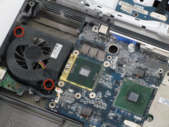

    1. Dell Inspiron E1705 Motherboard Replacement, Motherboard: step 16, image 1 of 3 Dell Inspiron E1705 Motherboard Replacement, Motherboard: step 16, image 2 of 3 Dell Inspiron E1705 Motherboard Replacement, Motherboard: step 16, image 3 of 3
      • Remove both fans from the computer. This will make it easier to remove the motherboard.
      Ask FixBot
    2. Dell Inspiron E1705 Motherboard Replacement: step 17, image 1 of 1
      • Remove the four screws holding the motherboard to the chassis.
      • Detach the connectors from the motherboard.
      Ask FixBot

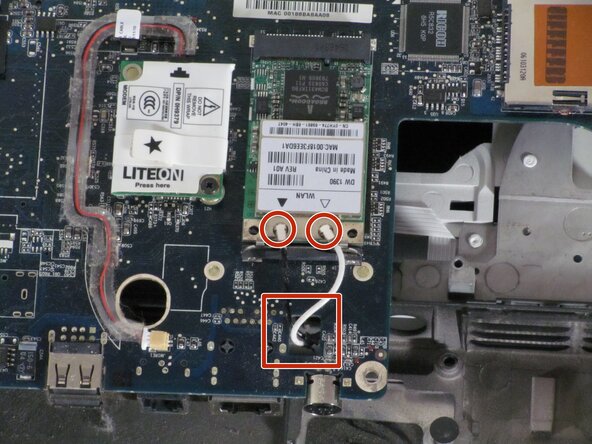

    3. Dell Inspiron E1705 Motherboard Replacement: step 18, image 1 of 3 Dell Inspiron E1705 Motherboard Replacement: step 18, image 2 of 3 Dell Inspiron E1705 Motherboard Replacement: step 18, image 3 of 3
      • Carefully angle the board to disengage the I/O ports from the side of the chassis.
      • Gently remove the motherboard from the laptop by simultaneously lifting and pulling away from the sides.
      • Once the motherboard is free, flip it over toward the laptop's screen and gently remove the black-and-white wire from the wireless card.
      • Once the wires are disconnected, pull them through the hole and completely remove the motherboard from the computer.
