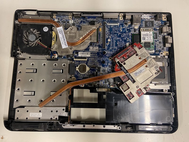

    6. Dell Inspiron E1505 GPU Replacement, GPU: step 6, image 1 of 3 Dell Inspiron E1505 GPU Replacement, GPU: step 6, image 2 of 3 Dell Inspiron E1505 GPU Replacement, GPU: step 6, image 3 of 3
      • Remove the two screws shown.
      • Use a spudger to pry the GPU and cooler up.
      • To reconnect the gpu, align it and firmly press at the "Press here" label.
      • Be careful when prying on the motherboard.
