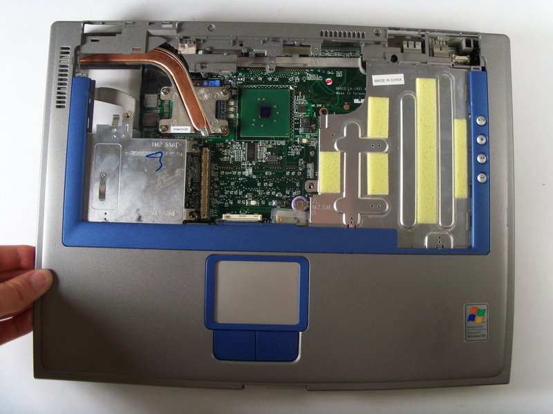

    1. Dell Inspiron 8600 Touch Pad Replacement, Touch Pad: step 9, image 1 of 1
      • Remove the palm rest assembly that secures the touch pad from the device.
      Ask FixBot

this is just the display guide with a footnote added, it doesn't tell you how to remove the touchpad
Tipsy The Cat - Reply Share
