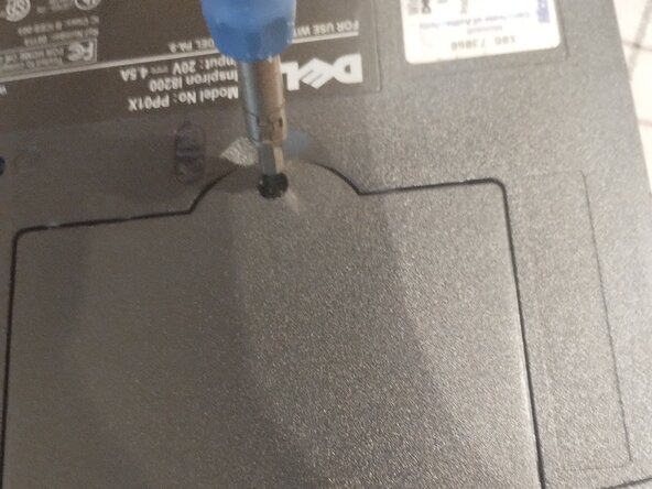

    1. Dell Inspiron 8200 Dial-Up Modem Card Replacement, Preparation: step 1, image 1 of 2 Dell Inspiron 8200 Dial-Up Modem Card Replacement, Preparation: step 1, image 2 of 2
      • First,The K/M Screw needs to be removed, Then remove the lid by prying next to the screw hole WITH YOUR FINGERS OR A PLASTIC SPUDGER, as metal can and will damage the plastic
