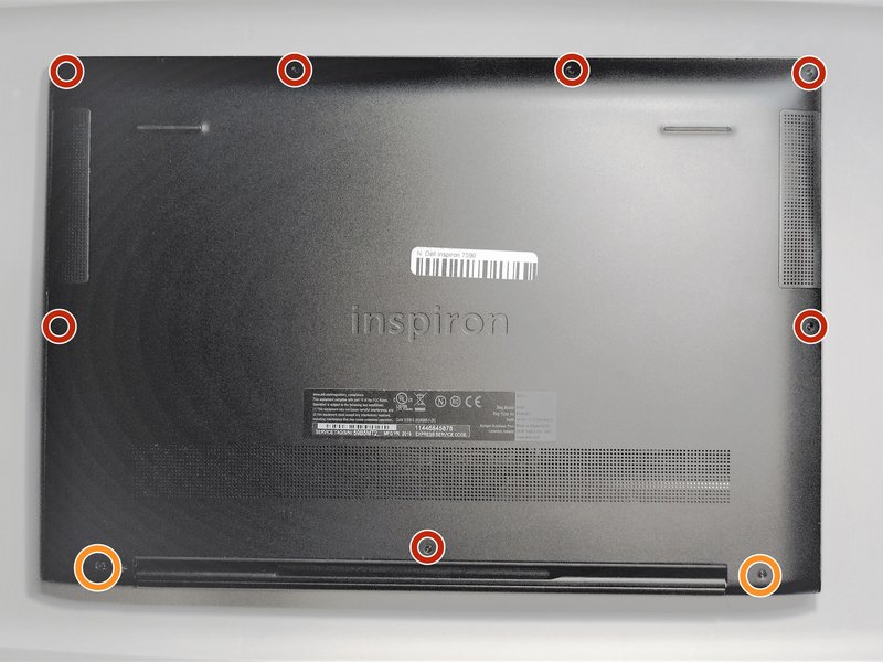

      • Use a Phillips #000 screwdriver to remove seven screws securing the base face of your device.
      • Unscrew the remaining two screws in the corners closest to the bottom of the base of the laptop.
