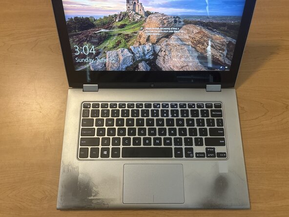

    1. Dell Inspiron 7348 2-in-1 RAM Replacement, RAM: step 1, image 1 of 2 Dell Inspiron 7348 2-in-1 RAM Replacement, RAM: step 1, image 2 of 2
      • Use a Phillips #0 screwdriver to remove ten 7mm screws from the back cover of the laptop.
      Ask FixBot
    2. Dell Inspiron 7348 2-in-1 RAM Replacement: step 2, image 1 of 1
      • Insert a plastic prying tool into the gap between the back cover and the base of the laptop.
      • Gently pry open the back cover by pushing the tool upwards.
      • Do not use a metal tool because the metal can cause electrostatic discharge damage to the laptop.
      Ask FixBot

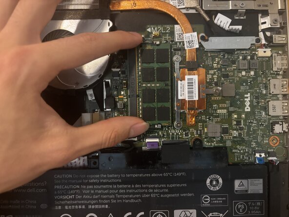

    3. Dell Inspiron 7348 2-in-1 RAM Replacement: step 3, image 1 of 3 Dell Inspiron 7348 2-in-1 RAM Replacement: step 3, image 2 of 3 Dell Inspiron 7348 2-in-1 RAM Replacement: step 3, image 3 of 3
      • Now that the hardware is exposed, make sure there is no danger of liquid spilling near the laptop and the lithium-ion battery inside.
      • Pinch and pry the metal prongs on either side of the RAM outwards.
      Ask FixBot

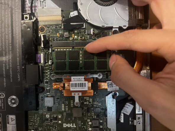

    4. Dell Inspiron 7348 2-in-1 RAM Replacement: step 4, image 1 of 2 Dell Inspiron 7348 2-in-1 RAM Replacement: step 4, image 2 of 2
      • The module will stick up at a 45-degree angle, meaning it is loose.
      • Remove the module from the socket.
