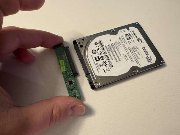

    4. Dell Inspiron 20 3043 Hard Drive Replacement, Remove the hard drive connector board: step 4, image 1 of 3 Dell Inspiron 20 3043 Hard Drive Replacement, Remove the hard drive connector board: step 4, image 2 of 3 Dell Inspiron 20 3043 Hard Drive Replacement, Remove the hard drive connector board: step 4, image 3 of 3
      • Peel the gaffer tape securing the hard drive connector board to the hard drive.
      • Pull the hard drive connector board straight off the hard drive.

    5. Dell Inspiron 20 3043 Hard Drive Replacement, Finish: step 5, image 1 of 1
      • Be mindful of the direction everything was facing: the plastic backing to the bracket should be on the PCB side of the hard drive, and the board should be facing with the connector port up when placed back inside the PC.
