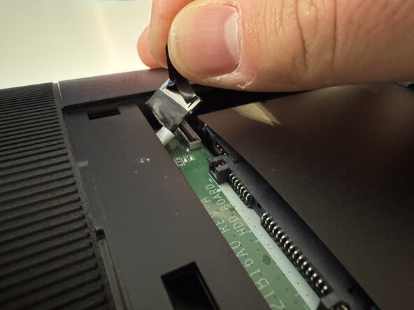

    4. Dell Inspiron 20 3043 CMOS Battery Replacement, Detach the back cover: step 4, image 1 of 2 Dell Inspiron 20 3043 CMOS Battery Replacement, Detach the back cover: step 4, image 2 of 2
      • Insert a spudger under the gap below the kickstand. Pry up to release the back cover from its clips.
      • If this is the first time the back cover is being removed, the clips can be pretty tight, and loosened clips can reattach when pressure is removed. Use an opening pick to keep the cover separate from the body while you loosen the other sides.
      • Do not lift the back cover completely off when fully detached. There are cables connected to the back cover.

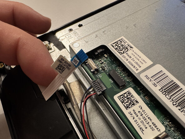

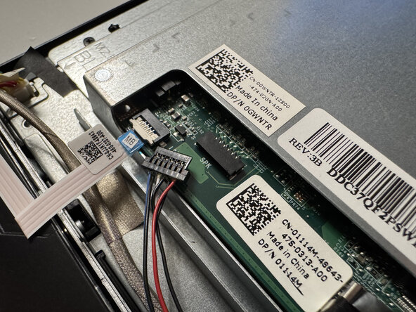

    10. Dell Inspiron 20 3043 CMOS Battery Replacement, Remove the speaker cable and power status light cable: step 10, image 1 of 3 Dell Inspiron 20 3043 CMOS Battery Replacement, Remove the speaker cable and power status light cable: step 10, image 2 of 3 Dell Inspiron 20 3043 CMOS Battery Replacement, Remove the speaker cable and power status light cable: step 10, image 3 of 3
      • Using tweezers or your fingernails, remove the speaker cable by pulling straight back on the plastic connector.
      • Using a spudger or your fingernail, lift the connector latch on the power status light cable. Remove by pulling straight back on the ribbon cable.

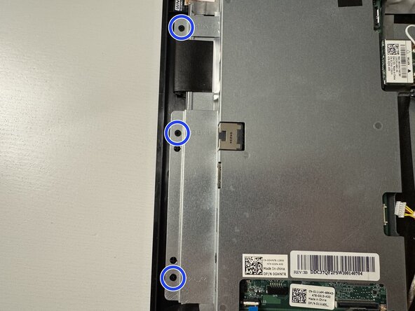

    11. Dell Inspiron 20 3043 CMOS Battery Replacement, Detach and flip the system board: step 11, image 1 of 2 Dell Inspiron 20 3043 CMOS Battery Replacement, Detach and flip the system board: step 11, image 2 of 2
      • Remove the three Phillips #0 screws holding the bracket to the body.
      • Flip the system board clockwise to reveal the underside of the board.
      • There may be tape holding the bracket to the body. This tape can be removed and replaced or stuck back on after repair.
