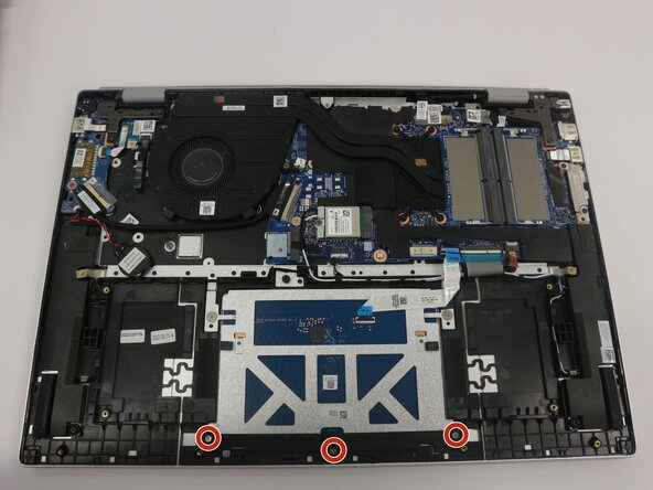

  7. Dell Inspiron 16 5625 Touchpad Replacement: step 7, image 1 of 3 Dell Inspiron 16 5625 Touchpad Replacement: step 7, image 2 of 3 Dell Inspiron 16 5625 Touchpad Replacement: step 7, image 3 of 3
    • Remove the three (M1.6x2) Phillips #0 screws that secure the touchpad bracket to the palm rest and keyboard assembly.
    • Remove the bracket on the lower lip of the touchpad.
