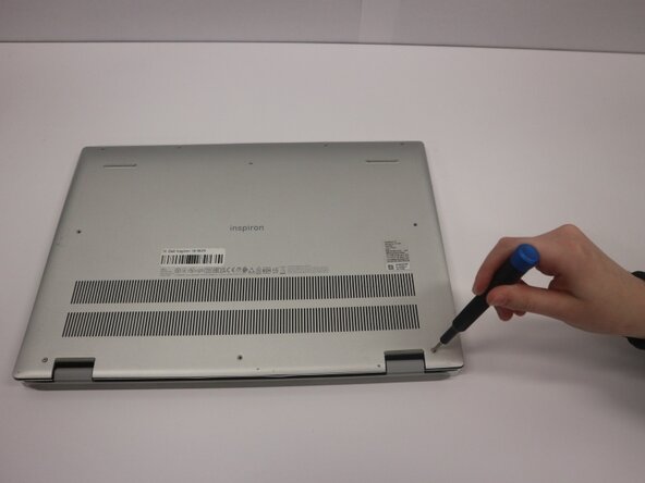

    • Remove the seven (M2x4) Phillips #0 screws securing the lower case.
    • Loosen the two (M2x7.5) captive Phillips #0 screws on the back cover by the hinges.

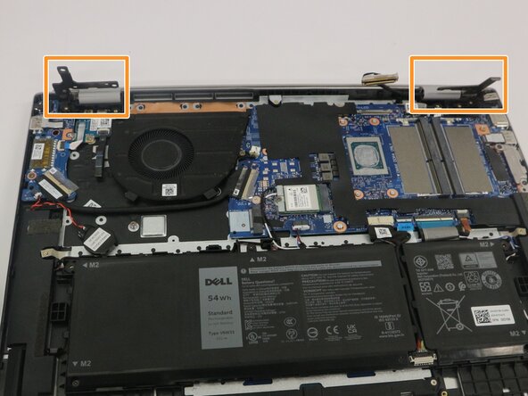

  4. Dell Inspiron 16 5625 Display Assembly Replacement, Display Assembly: step 4, image 1 of 3 Dell Inspiron 16 5625 Display Assembly Replacement, Display Assembly: step 4, image 2 of 3 Dell Inspiron 16 5625 Display Assembly Replacement, Display Assembly: step 4, image 3 of 3
    • Remove the five (M2.5x5) Phillips #1 screws that secure both display hinges of the display assembly to the system board.
    • Open both display hinges to about a 90 degree angle.
