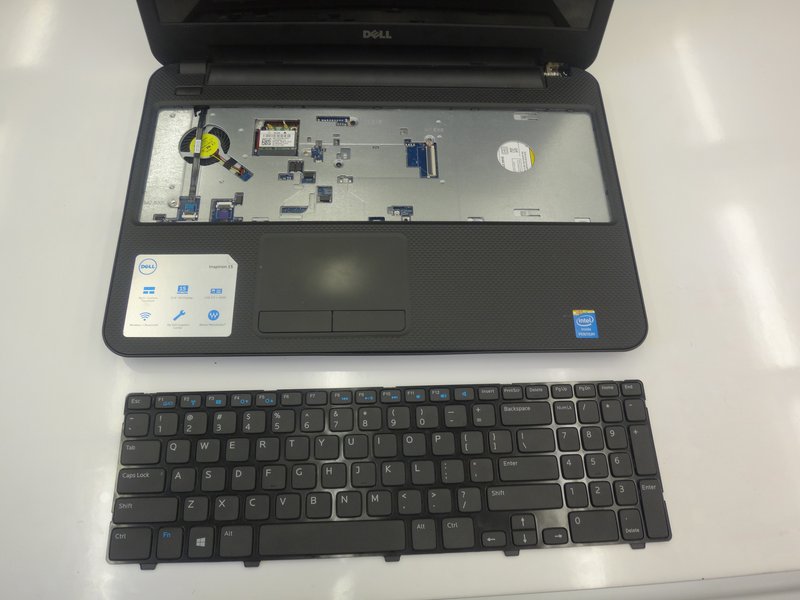

    2. Dell Inspiron 15-3521 Keyboard Replacement, Removing Keyboard: step 2, image 1 of 3 Dell Inspiron 15-3521 Keyboard Replacement, Removing Keyboard: step 2, image 2 of 3 Dell Inspiron 15-3521 Keyboard Replacement, Removing Keyboard: step 2, image 3 of 3
      • Flip laptop right side up
      • Using a flat head screwdriver, depress locking tabs holding keyboard into place
      • Using a spudger, pry the keyboard from the laptop, giving room to access with hands.
      • Using hands, remove keyboard completely from laptop body, leaving only the connecting cord that attaches the keyboard to the laptop.

    3. Dell Inspiron 15-3521 Keyboard Replacement, Disconnecting the Keyboard Cable: step 3, image 1 of 3 Dell Inspiron 15-3521 Keyboard Replacement, Disconnecting the Keyboard Cable: step 3, image 2 of 3 Dell Inspiron 15-3521 Keyboard Replacement, Disconnecting the Keyboard Cable: step 3, image 3 of 3
      • To disconnect the keyboard, locate the keyboard cable locking mechanism.
      • Open the locking mechanism by gently pulling up.
      • Slide out the keyboard cable from the interface to separate the keyboard form the laptop.
