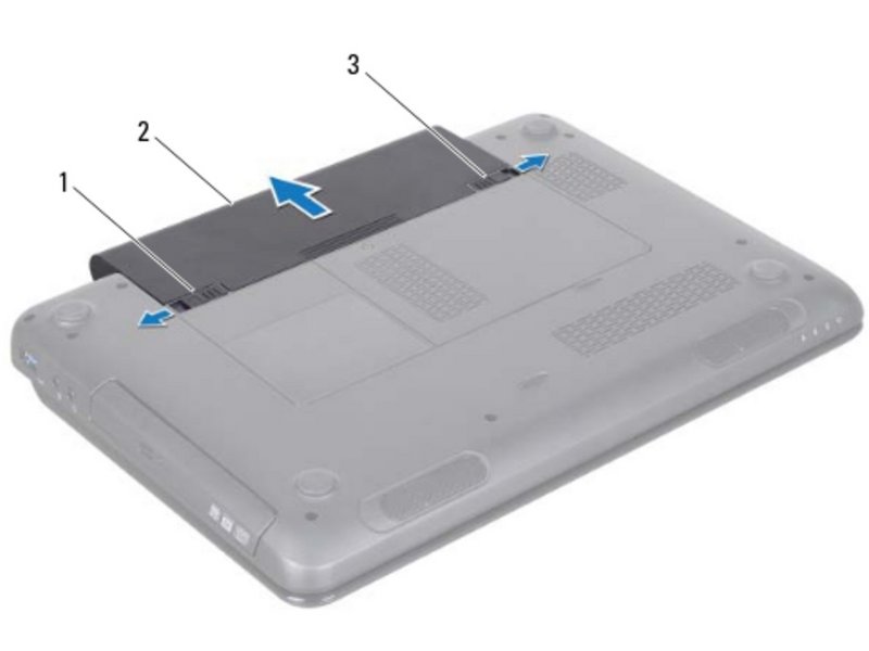

    1. Dell Inspiron 14R Battery Replacement, Turn Over the Computer: step 1, image 1 of 1
      • WARNING: Before working inside your computer, read the safety information that shipped with your computer. Follow the instructions in "Before You Begin".
      • CAUTION: To avoid electrostatic discharge, ground yourself by using a wrist grounding strap or by periodically touching an unpainted metal surface (such as a connector on your computer).
      • Shut down the computer and turn it over.
      Ask FixBot
    2. Dell Inspiron 14R Battery Replacement, Sliding the Battery Latch: step 2, image 1 of 1
      • Slide the battery release latch to the unlock position.
      Ask FixBot
    3. Dell Inspiron 14R Battery Replacement, Sliding the Battery: step 3, image 1 of 1
      • Slide and lift the battery out of the battery bay.
      Ask FixBot
    4. Dell Inspiron 14R Battery Replacement, Sliding the Battery: step 4, image 1 of 1
      • Slide the NEW battery into the battery bay until it clicks into place.
      Ask FixBot
    5. Dell Inspiron 14R Battery Replacement, Sliding the Battery Latch: step 5, image 1 of 1
      • Slide the battery lock latch to the lock position.
