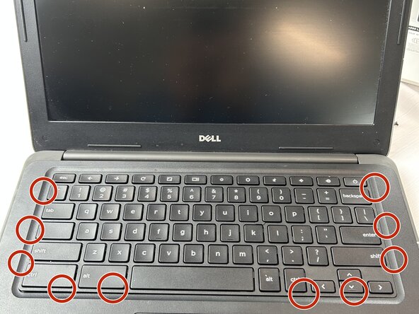

  7. Dell Chromebook 13 3380 Keyboard Replacement: step 7, image 1 of 1
    • Flip the unit over and open the screen.
    • Gently insert a flat prying tool and unclip the ten plastic clips to pop the keyboard free.
    Ask FixBot
  8. Dell Chromebook 13 3380 Keyboard Replacement: step 8, image 1 of 1
    • Gently remove the keyboard from the laptop.
    Ask FixBot
