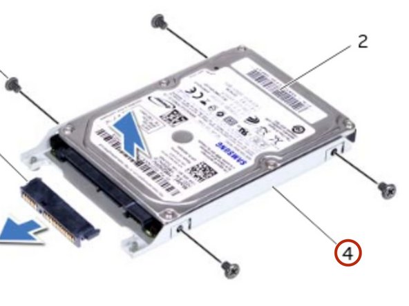

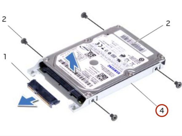

    4. Dell Alienware M17x R4 Hard Drive Replacement, Remove the Screws: step 4, image 1 of 1
      • Remove the screws that secure the hard drive to the hard-drive bracket.
      Ask FixBot
    5. Dell Alienware M17x R4 Hard Drive Replacement, Lifting the Hard-Drive: step 5, image 1 of 2 Dell Alienware M17x R4 Hard Drive Replacement, Lifting the Hard-Drive: step 5, image 2 of 2
      • Lift the hard-drive off the hard-drive bracket.

    6. Dell Alienware M17x R4 Hard Drive Replacement, Remove the Interposer: step 6, image 1 of 1
      • Remove the interposer from the hard drive.
