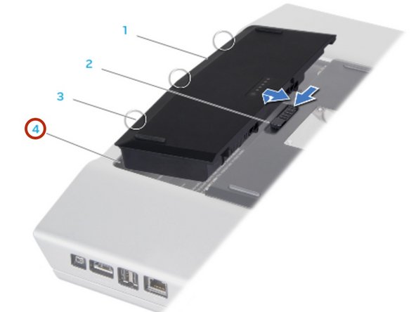

    2. Dell Alienware M17x Battery Pack Replacement, Slide the Battery Latch: step 2, image 1 of 1
      • Slide the battery latch to the unlock position as shown.
      Ask FixBot
    3. Dell Alienware M17x Battery Pack Replacement, Popping out the Battery Pack: step 3, image 1 of 1
      • The battery pack will pop up.
      Ask FixBot
    4. Dell Alienware M17x Battery Pack Replacement, Removing the Battery Pack: step 4, image 1 of 1
      • Remove the battery pack.
      Ask FixBot
    5. Dell Alienware M17x Battery Pack Replacement, Aligning the Battery Pack Tabs: step 5, image 1 of 1
      • Align the battery pack tabs with the slots in the battery bay.
      Ask FixBot
    6. Dell Alienware M17x Battery Pack Replacement, Sliding the Battery Pack: step 6, image 1 of 2 Dell Alienware M17x Battery Pack Replacement, Sliding the Battery Pack: step 6, image 2 of 2
      • Slide the NEW battery pack into the battery bay until the battery pack clicks into place.
