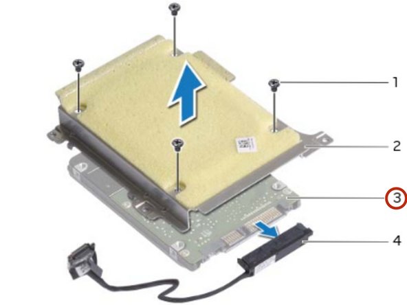

    4. Dell Alienware 17 Third Hard-Drive Replacement, Disconnect the Interposer: step 13, image 1 of 2 Dell Alienware 17 Third Hard-Drive Replacement, Disconnect the Interposer: step 13, image 2 of 2
      • Disconnect the interposer from the hard drive.
      Ask FixBot
    5. Dell Alienware 17 Third Hard-Drive Replacement, Remove the Screws: step 14, image 1 of 1
      • Remove the screws that secure the hard-drive bracket to the hard drive.
      Ask FixBot
    6. Dell Alienware 17 Third Hard-Drive Replacement, Lifting the Hard-Drive Bracket: step 15, image 1 of 2 Dell Alienware 17 Third Hard-Drive Replacement, Lifting the Hard-Drive Bracket: step 15, image 2 of 2
      • Lift the hard-drive bracket off the hard drive.
      Ask FixBot
    7. Dell Alienware 17 Third Hard-Drive Replacement, Align the Screw Holes: step 16, image 1 of 1
      • Align the screw holes on the NEW hard-drive bracket with the screw holes on the hard drive.
      Ask FixBot
    8. Dell Alienware 17 Third Hard-Drive Replacement, Replace the Screws: step 17, image 1 of 1
      • Replace the screws that secure the hard-drive bracket to the hard drive.
      Ask FixBot
    9. Dell Alienware 17 Third Hard-Drive Replacement, Connect the Interposer: step 18, image 1 of 1
      • Connect the interposer to the hard drive.
