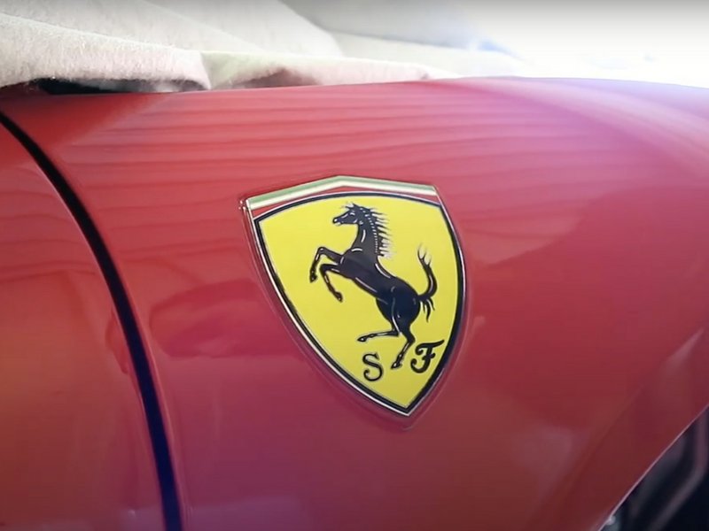

    1. Debadging a Ferrari, Find and remove any bolts: step 1, image 1 of 2 Debadging a Ferrari, Find and remove any bolts: step 1, image 2 of 2
      • Depending on the model of Ferrari you own, you may need to remove several bolts that hold the badge in place.
      • The badge that is being removed in this tutorial is from the Ferrari 458's front passenger side, and the bolts can be found underneath the inner wheel well.
