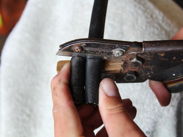

    13. Datsun 280z Fuel Line Replacement: step 13, image 1 of 3 Datsun 280z Fuel Line Replacement: step 13, image 2 of 3 Datsun 280z Fuel Line Replacement: step 13, image 3 of 3
      • With the hose cutters, cut off a piece of the new fuel injector hose that is the same size as the old fuel lines.
      Ask FixBot
