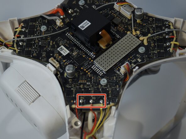

    • Remove the glue around the three wires that connect the motor to the flight controller with a metal spudger.
    • Repeat this step for each arm you plan to remove a motor from.
  10. DJI Phantom 3 Standard Propeller Motors Replacement: step 10, image 1 of 2 DJI Phantom 3 Standard Propeller Motors Replacement: step 10, image 2 of 2
    • Desolder the three wires connected to the flight controller from the motor.
    • For soldering tips, check out this guide.
    • Remove the motor and repeat for each motor as needed
