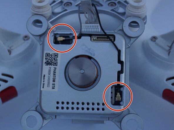

  4. DJI Phantom 3 Standard Gimbal Replacement: step 4, image 1 of 2 DJI Phantom 3 Standard Gimbal Replacement: step 4, image 2 of 2
    • Remove four 8mm screws from the two small covers on the back using a Phillips #00 screwdriver.
    • Flip over the mount.
    Ask FixBot
  5. DJI Phantom 3 Standard Gimbal Replacement: step 5, image 1 of 2 DJI Phantom 3 Standard Gimbal Replacement: step 5, image 2 of 2
    • Use an opening tool to pop the coverings off the back of the gimbal, allowing the wire connections to become visible.

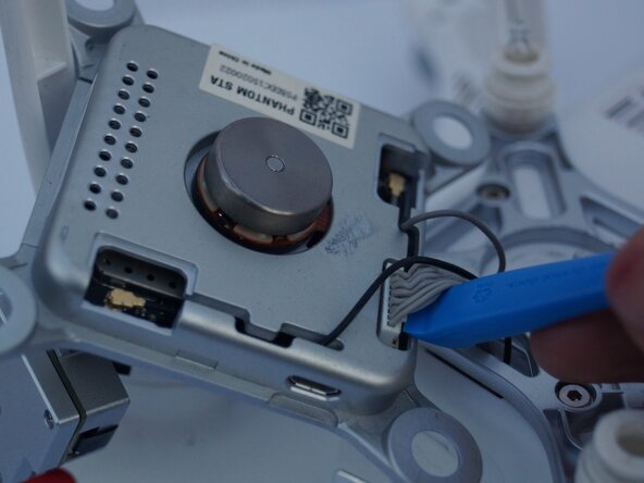

  6. DJI Phantom 3 Standard Gimbal Replacement: step 6, image 1 of 2 DJI Phantom 3 Standard Gimbal Replacement: step 6, image 2 of 2
    • Use the opening tool to remove the white/grey cords by pushing up against the side with the lip.
    • You want to push the lip in and pull the cord out.
    Ask FixBot
  7. DJI Phantom 3 Standard Gimbal Replacement: step 7, image 1 of 3 DJI Phantom 3 Standard Gimbal Replacement: step 7, image 2 of 3 DJI Phantom 3 Standard Gimbal Replacement: step 7, image 3 of 3
    • Slowly disconnect the wires by circling the connection point and lifting up slightly until it is free.
    • Use an opening tool to disconnect the wires from the board.
    • Remove the gimbal.
