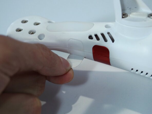

    4. DJI Phantom 3 Standard Cover Replacement: step 5, image 1 of 2 DJI Phantom 3 Standard Cover Replacement: step 5, image 2 of 2
      • Carefully peel off all of the red stickers until the seam for the cover is no longer covered.
      Ask FixBot

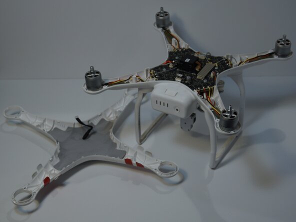

    5. DJI Phantom 3 Standard Cover Replacement: step 6, image 1 of 3 DJI Phantom 3 Standard Cover Replacement: step 6, image 2 of 3 DJI Phantom 3 Standard Cover Replacement: step 6, image 3 of 3
      • Remove the plastic shell by going around the entire seam with the plastic opening tool.
      • Hearing the plastic click loudly is a good sign, but you shouldn't hear any cracks or breaks.
      • Don't go too fast, or you may risk cracking the cover.
      Ask FixBot
    6. DJI Phantom 3 Standard Cover Replacement: step 7, image 1 of 3 DJI Phantom 3 Standard Cover Replacement: step 7, image 2 of 3 DJI Phantom 3 Standard Cover Replacement: step 7, image 3 of 3
      • Don’t fully pull off the cover yet as there is a ribbon cable that needs to be freed.
      • Disconnect the ribbon cable.
      • Remove the cover.
