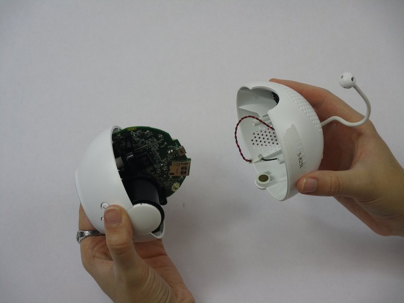

    2. D-Link DCS-825L Back Casing Replacement: step 5, image 1 of 3 D-Link DCS-825L Back Casing Replacement: step 5, image 2 of 3 D-Link DCS-825L Back Casing Replacement: step 5, image 3 of 3
      • Pull the Wi-Fi Baby Camera open.
      • It should be easily done after the screws are removed.
      Ask FixBot

    4. D-Link DCS-825L Back Casing Replacement: step 7, image 1 of 3 D-Link DCS-825L Back Casing Replacement: step 7, image 2 of 3 D-Link DCS-825L Back Casing Replacement: step 7, image 3 of 3
      • Take your tweezers and gently pull the white tip that is on the end of the white wire (the antenna) out from its plug in.
      Ask FixBot
