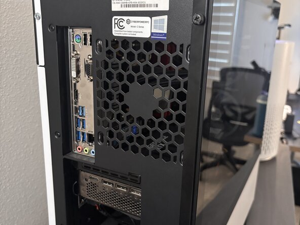

  2. CyberPower ET9430-7569 CMOS Battery Replacement: step 2, image 1 of 1
    • Loosen and remove the two screws securing the left side of the glass panel by hand.
    • Optional: Use a Phillips screwdriver if the screws cannot be loosened by hand.
    Ask FixBot

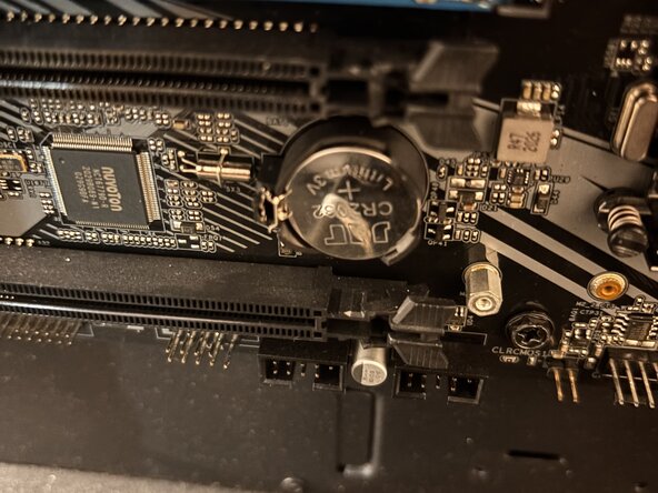

  8. CyberPower ET9430-7569 CMOS Battery Replacement: step 8, image 1 of 2 CyberPower ET9430-7569 CMOS Battery Replacement: step 8, image 2 of 2
    • Gently push the retaining clip away from the CMOS battery to release it.
    • The battery will pop up slightly—remove it carefully by hand.
    • Avoid using metal tools directly on the motherboard to prevent damage. Use a small tip plastic tool instead.
    • Insert the new battery with the positive (+) side facing up until it clicks into place.
