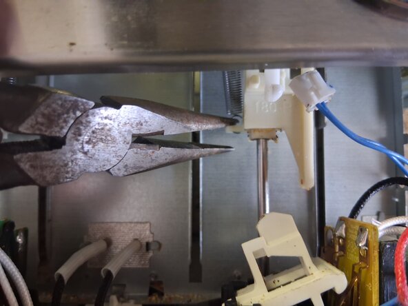

  4. Cuisinart CPT-180 Toaster Lever Repair: step 4, image 1 of 3 Cuisinart CPT-180 Toaster Lever Repair: step 4, image 2 of 3 Cuisinart CPT-180 Toaster Lever Repair: step 4, image 3 of 3
    • Read the entire step before attempting!
    • If your cable connectors are still attached after removing the toaster case, use needle-nose pliers to unplug the connectors from their sockets.
    • The socket and connector look very similar. The connector is the smaller white piece connected to the cable, and the socket is the larger white piece surrounding it. If you remove the socket, you will damage the circuit board.
    • Repeat for both cable connectors and both sides.

  6. Cuisinart CPT-180 Toaster Lever Repair: step 6, image 1 of 3 Cuisinart CPT-180 Toaster Lever Repair: step 6, image 2 of 3 Cuisinart CPT-180 Toaster Lever Repair: step 6, image 3 of 3
    • After cleaning, use your needle-nose pliers to manually push the lever pole and spring into their connection points. Ensure they are securely attached, and the lever pole slides smoothly.
    • The shell of your toaster, if still attached, may slide during this step. Ensure it doesn't get caught on loose wires or cables.
    • Repeat the step for both sides.
