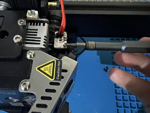

      • Move the toolhead all the way to the left by homing the printer (indicated by the red arrow).
      • Place the printer on its left side.
      • Be sure to place it on its left side to avoid laying the printer on its control screen. (Indicated by orange arrow)
      • The third photo contains the parts that will be replaced in this guide. The red square is the heat shoe. The yellow square is the two M1.5x1.6 socket-head screws. The red circle is the set screw. The green arrow is the plug for the ceramic heater, while the pink arrow is for the thermistor.

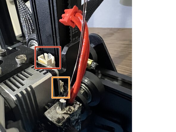

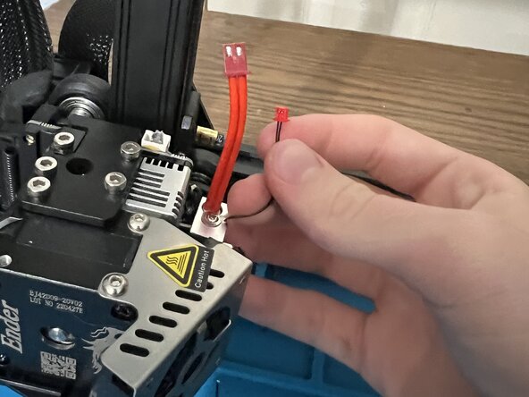

      • Before beginning the disassembly, ensure the heating elements have returned to room temperature.
      • Having a pair of tweezers (Optional) may make the removal of the two connectors easier.
      • Disconnect the ceramic heater connector from the port.
      • Unplug the thermistor from the port.
      • The ceramic heater connector is the bigger of the two cables.
      • This unit is damaged, and the thermistor port is slightly melted. Yours should look different.

      • Use a 1.5mm Hex screwdriver to remove the two 1.6 mm socket-head bolts.
      • Gently pull the hotend out of the assembly.
