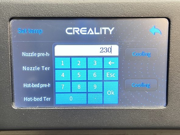

    • Go to your LCD Screen >Temp > Manual >Nozzle Pre-Heat.
    • Pre-heat the nozzle to 230C.
    • The heat will loosen the nozzle so it can be unscrewed.
