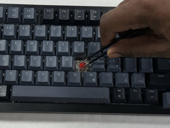

    1. Corsair K65 Plus Wireless Key Switch Replacement, Key Switch: step 3, image 1 of 2 Corsair K65 Plus Wireless Key Switch Replacement, Key Switch: step 3, image 2 of 2
      • Use a key switch puller to grip the key switch and pull straight up to remove it.
