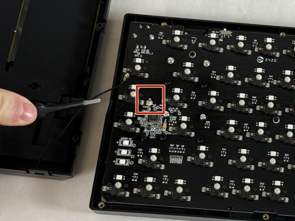

    7. Corsair K65 Plus Wireless Key Stabilizer Replacement: step 7, image 1 of 2 Corsair K65 Plus Wireless Key Stabilizer Replacement: step 7, image 2 of 2
      • Slide a thin, ESD-safe pry tool or angled tweezers under the metal neck of the connector (as close to the head as possible) and lift straight up from the board.
      • Carefully disconnect the multi-purpose indicator light cable from the PCB.
      • Set the back cover aside once all cables are disconnected.
