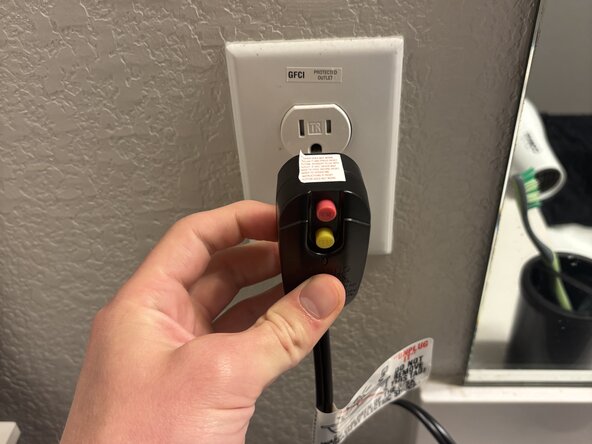

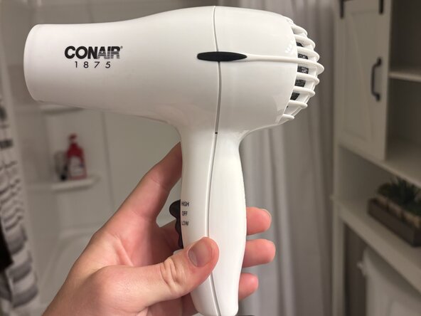

      • Step 1: Make sure your hairdryer is unplugged and not currently hot to touch from recent use, before starting the disassembly process.

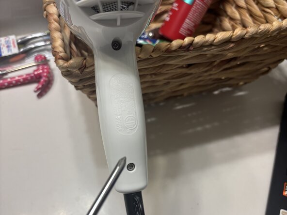

      • Step 2: Unscrew the nails from the back panel of the hair dryer. Use a Phillips head screwdriver and inspect the back of the hair dryer. Unscrew both of the screws in the back. The top screw may not completely come out but be sure it is loose enough where you can remove the panel

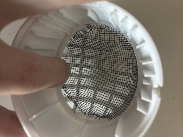

      • Step 4: Remove the mesh filter from the inside of the panel.
      • You can use either tweezers or your fingers. Carefully remove the mesh from the panel. It can get stuck, so remove with care. Make sure not to rush this step or else you can damage the filter.
