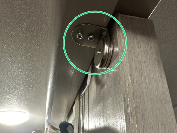

    1. Closet Door Magnetic Catch/Strike Plate Replacement, Magnetic Catch and Strike Plate: step 1, image 1 of 3 Closet Door Magnetic Catch/Strike Plate Replacement, Magnetic Catch and Strike Plate: step 1, image 2 of 3 Closet Door Magnetic Catch/Strike Plate Replacement, Magnetic Catch and Strike Plate: step 1, image 3 of 3
      • Verify that the original magnetic catch is loose due to a stretched screw hole in the closet space.
      • Inspect the strike plate and screw for damage or excessive wear.
      • Check that the mounting hole is stripped before beginning the repair.

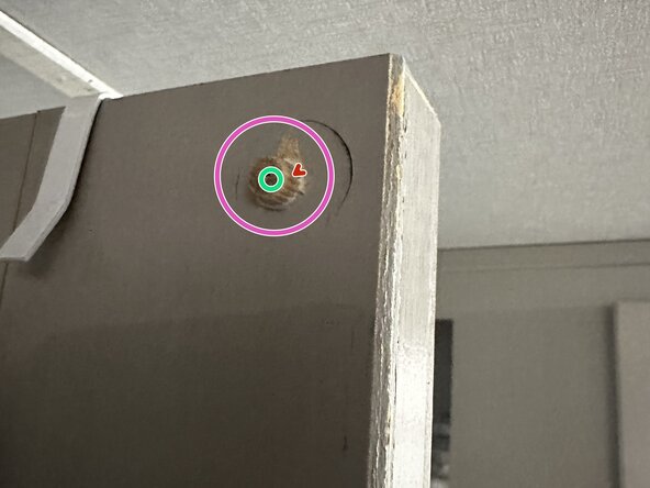

    2. Closet Door Magnetic Catch/Strike Plate Replacement: step 2, image 1 of 3 Closet Door Magnetic Catch/Strike Plate Replacement: step 2, image 2 of 3 Closet Door Magnetic Catch/Strike Plate Replacement: step 2, image 3 of 3
      • Use a 3/8-inch drill bit to carefully drill out the stretched screw hole in the closet door.
      • Wear safety glasses while drilling to protect your eyes from wood chips and debris.
      • Remove any loose wood debris from the hole.
      • Verify that the 3/8-inch fluted wood dowel fits snugly in the enlarged hole
      • Clean debris from the repair area before proceeding.

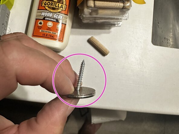

    3. Closet Door Magnetic Catch/Strike Plate Replacement: step 3, image 1 of 3 Closet Door Magnetic Catch/Strike Plate Replacement: step 3, image 2 of 3 Closet Door Magnetic Catch/Strike Plate Replacement: step 3, image 3 of 3
      • Apply Gorilla Wood Glue inside the enlarged 3/8-inch hole in the closet door.
      • Coat a 3/8- inch fluted wood dowel with wood glue.
      • Insert the dowel into the hole and gently tap it in with a hammer until it is fully seated.
      • Wipe away any excess glue.
      • Allow the Gorilla Wood Glue to cure according to the manufacturer's instructions before trimming the dowel or reinstalling the hardware.

The stretched screw hole was successfully repaired using a 3/8-inch fluted wood dowel and Gorilla Wood Glue. After trimming the dowel flush with the closet door, the magnetic catch was reinstalled and tested. The magnetic catch now holds the closet door securely, allowing it to open and close as intended.
