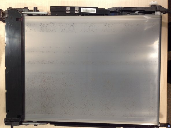

    1. Cleaning the Intermediate Transfer Belt (ITB), Diagnosis: step 1, image 1 of 3 Cleaning the Intermediate Transfer Belt (ITB), Diagnosis: step 1, image 2 of 3 Cleaning the Intermediate Transfer Belt (ITB), Diagnosis: step 1, image 3 of 3
      • The distance between repetitions of a print quality problem provides the best clue to identify the source. Intermediate transfer belt problems repeat every 70cm which corresponds to 2.3 A4 pages. Intermittent dark vertical strips indicate that the Intermediate Transfer belt is not being effectively cleaned.
      • Experience from a school that prints 200,000 pages a year on these printers shows the majority of print quality problems are caused by the toner cartridges rather than the ITB. The cause of these faults is readily proved by swapping cartridges. Typically 5% to 20% of compatible toner cartridges cause print quality problems.
      • For the small minority of quality problems that persist across multiple toner cartridges, the cause of dirty printouts has usually been the ITB.
      • Other guides describe manually cleaning the belt which, although easy to do, provides only a short term benefit if the underlying cause is that the wiper blade is not cleaning the belt.
      • A roughness as the belt passes over the roller might be caused by disintegrating foam rollers that support the belt from inside the ITB unit. Replacing the entire ITB unit may be the only solution in this case.

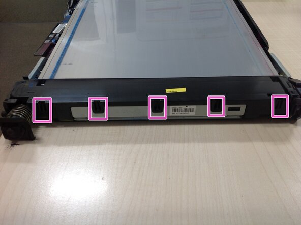

    2. Cleaning the Intermediate Transfer Belt (ITB), Remove waste toner: step 3, image 1 of 1
      • Gently pull back the five plastic clips holding down the lid on the toner collector attached to the end of the Intermediate Transfer Belt.
      • The plastic lid can now be lifted off the toner collector. After a little gentle wiggling it will come away.
      • The toner collector is full of old toner powder that might spill out if you remove the lid carelessly.
      • The waste toner can now be emptied out

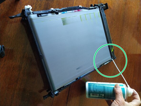

    3. Cleaning the Intermediate Transfer Belt (ITB), Clean the foam strip: step 5, image 1 of 3 Cleaning the Intermediate Transfer Belt (ITB), Clean the foam strip: step 5, image 2 of 3 Cleaning the Intermediate Transfer Belt (ITB), Clean the foam strip: step 5, image 3 of 3
      • Cleaning the foam strip on the underside of the ITB may improve the quality.
      • The foam strip can be lifted slightly when cleaning to creat a gap for the waste toner to escape
      • Compressed air can remove the waste toner from behind the foam strip.
      • A thin plastic sheet can be inserted between the foam and the belt, then dragged along. The lumps shown in the picture were extracted in this way.
