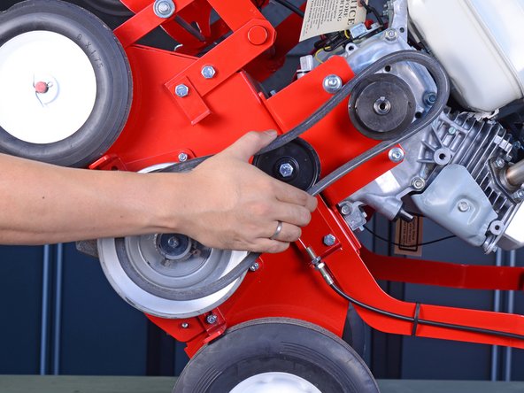

  7. Classen Over Seeder TS20HD 2012 Drive Pulley Replacement, Rake Belt: step 7, image 1 of 2 Classen Over Seeder TS20HD 2012 Drive Pulley Replacement, Rake Belt: step 7, image 2 of 2
    • Use your fingers to pry the belt off the drive pulley.
    • If you are having trouble, make sure that the machine is not resting on the bail bar up by the handlebars, which tightens the idler pulley.
    Ask FixBot
  8. Classen Over Seeder TS20HD 2012 Drive Pulley Replacement: step 8, image 1 of 3 Classen Over Seeder TS20HD 2012 Drive Pulley Replacement: step 8, image 2 of 3 Classen Over Seeder TS20HD 2012 Drive Pulley Replacement: step 8, image 3 of 3
    • Squeeze the belt and unhook it from the engine pulley.
    • Remove the rake belt.

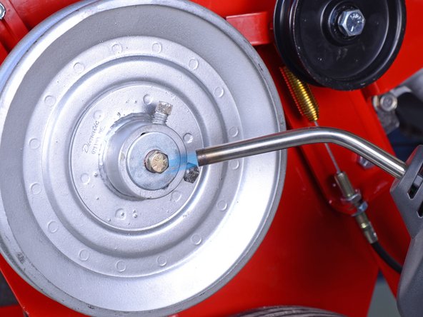

  10. Classen Over Seeder TS20HD 2012 Drive Pulley Replacement: step 10, image 1 of 2 Classen Over Seeder TS20HD 2012 Drive Pulley Replacement: step 10, image 2 of 2
    • Use a 7/16" socket and socket wrench to remove the center pulley bolt.
    • The bolt can be heavily thread-locked in place, and the bolt head can shear off easily. To prevent breakage, use a torch and heat the bolt for two minutes to weaken the thread-lock.
    Ask FixBot
  11. Classen Over Seeder TS20HD 2012 Drive Pulley Replacement: step 11, image 1 of 1
    • Remove the bolt, along with the pulley retainer washer and crush washer.
    • Re-assembly tip: Replace the crush washer with a new one and apply red thread-locker to the bolt threads.
