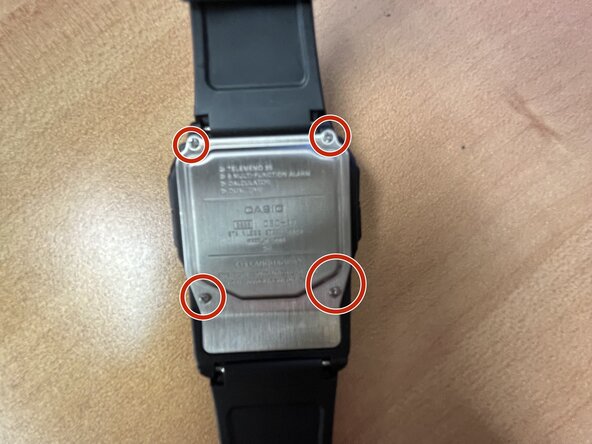

    1. Casio Databank 2888 DBC-32 Battery Replacement, Remove Screws Holding Caseback on: step 1, image 1 of 1
      • Using a PH000 driver unscrew the 4 screws holding the caseback on
