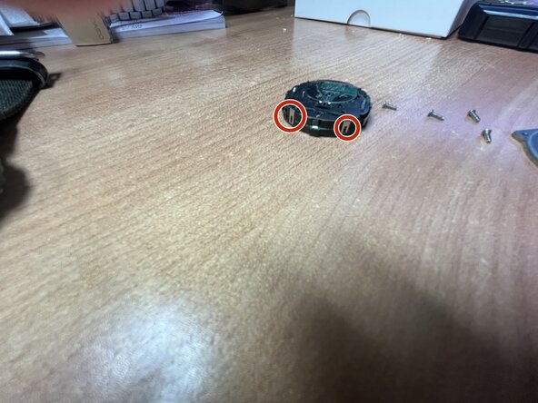

  3. Casio 3157 SGW-100 Battery Replacement, Pry off the clips holding the movement together: step 3, image 1 of 3 Casio 3157 SGW-100 Battery Replacement, Pry off the clips holding the movement together: step 3, image 2 of 3 Casio 3157 SGW-100 Battery Replacement, Pry off the clips holding the movement together: step 3, image 3 of 3
    • gently pull the clips up to release the back half of the movement from the front of it
    Ask FixBot
    • Insert a new 2025 cell
