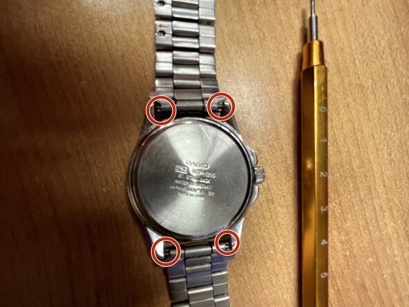

  2. Casio 2784 Mtp-1215 Battery Replacement, Remove the Springbars from the case: step 2, image 1 of 3 Casio 2784 Mtp-1215 Battery Replacement, Remove the Springbars from the case: step 2, image 2 of 3 Casio 2784 Mtp-1215 Battery Replacement, Remove the Springbars from the case: step 2, image 3 of 3
    • Remove the Springbars holding the band to the case
