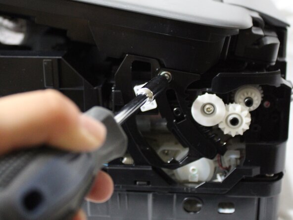

  3. Canon PIXMA TS6420a Scanner Lid Hinge Replacement: step 3, image 1 of 2 Canon PIXMA TS6420a Scanner Lid Hinge Replacement: step 3, image 2 of 2
    • Remove the single screw from the inside front edge under the lid securing the scanner frame using a Phillips #0 screwdriver.
    • Remove the two screws from the back side of the printer using a Phillips #0 screwdriver.

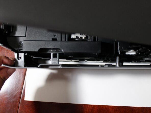

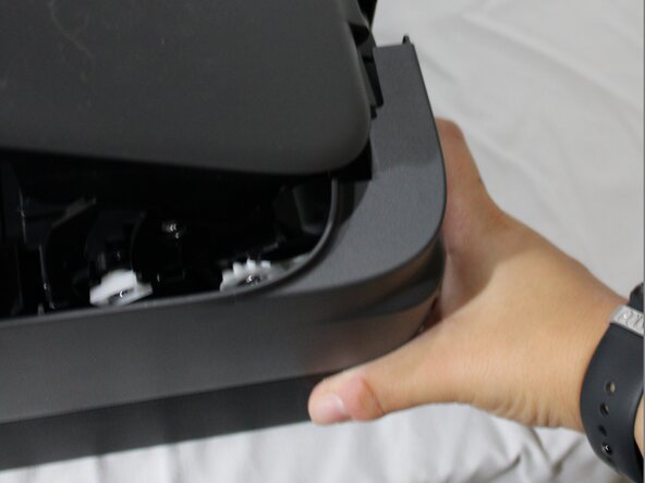

  4. Canon PIXMA TS6420a Scanner Lid Hinge Replacement: step 4, image 1 of 2 Canon PIXMA TS6420a Scanner Lid Hinge Replacement: step 4, image 2 of 2
    • Use a spudger to release the plastic clips along the frame edges.
    • Gently pry the frame loose, working around the perimeter to avoid cracking the plastic.
    • Lift off the frame to reveal the hinge and gear assembly.
    • Some clips may resist slightly; apply gently, even pressure.

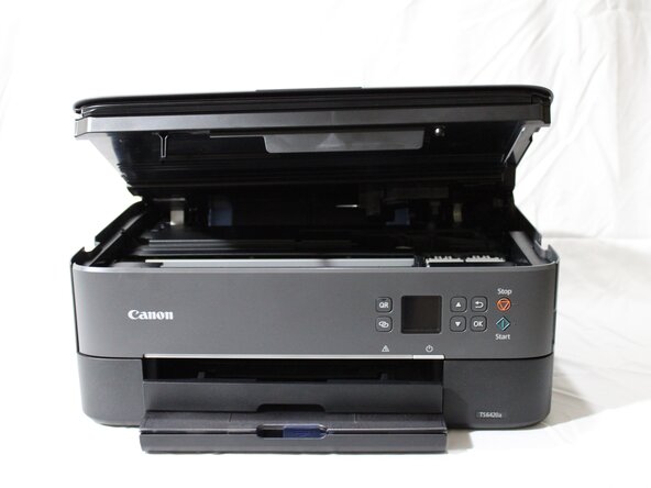

  5. Canon PIXMA TS6420a Scanner Lid Hinge Replacement: step 5, image 1 of 1
    • Use a soft support (like a towel, small box, or rolled cloth) to hold the lid in place while you work.
    • Caution: Do not let the lid hang unsupported; it could strain or crack the remaining hinge.

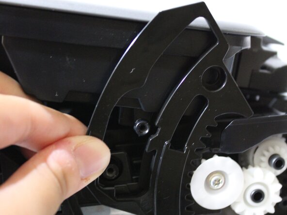

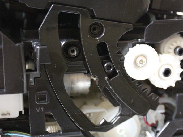

  6. Canon PIXMA TS6420a Scanner Lid Hinge Replacement: step 6, image 1 of 3 Canon PIXMA TS6420a Scanner Lid Hinge Replacement: step 6, image 2 of 3 Canon PIXMA TS6420a Scanner Lid Hinge Replacement: step 6, image 3 of 3
    • Use the Phillips #3 screwdriver to remove the two screws securing the hinge mechanism.
    • Carefully lift the hinge assembly out of its tracks, taking care not to bend or twist the arms.
    • Take a photo before removing the hinge if you want to reference how it was positioned.

  7. Canon PIXMA TS6420a Scanner Lid Hinge Replacement: step 7, image 1 of 3 Canon PIXMA TS6420a Scanner Lid Hinge Replacement: step 7, image 2 of 3 Canon PIXMA TS6420a Scanner Lid Hinge Replacement: step 7, image 3 of 3
    • Align the new hinge with the same tracks where the old one was seated.
    • Slide it into place until it sits flush.
    • Reinsert and tighten the two hinge screws using the Phillips #3 screwdriver.
