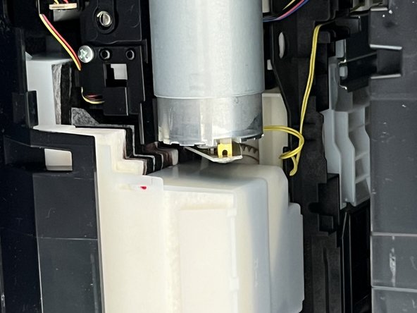

    2. Canon PIXMA MX925 Ink Absorber Replacement, Removing the ink absorber box: step 2, image 1 of 2 Canon PIXMA MX925 Ink Absorber Replacement, Removing the ink absorber box: step 2, image 2 of 2
      • Loosen the Phillips screws on the back and next to the drive area.
      • Push the ink absorber box slightly to the right and pull it out.
      • Use paper towels to catch any old ink.
      • Note the position of the tubes and plastic tabs before reinserting the box.
      • Avoid touching the soiled sponges as much as possible.
      Ask FixBot
      • Reinstall the ink absorber sponge box, the tubes, and the covers in reverse order.
      • Tighten the screws only until they are finger-tight.
      • Restart the printer and perform a test print.
      • If the support code 1700 persists, you may need to reset the ink absorber counter depending on your model.
      Ask FixBot
Perform the steps in reverse order and then check with a test print. If support code 1700 is still displayed, you may need to reset the ink absorber counter depending on the model.
