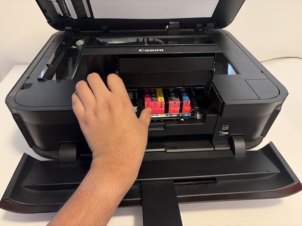

    4. Canon PIXMA MX922 Printhead Replacement: step 4, image 1 of 3 Canon PIXMA MX922 Printhead Replacement: step 4, image 2 of 3 Canon PIXMA MX922 Printhead Replacement: step 4, image 3 of 3
      • Lift open the ink cover
      Ask FixBot
    5. Canon PIXMA MX922 Printhead Replacement: step 5, image 1 of 2 Canon PIXMA MX922 Printhead Replacement: step 5, image 2 of 2
      • Once the ink cover is open, wait for the print holder to stop in the middle of the printer and all ink cartridges are visible.
      Ask FixBot

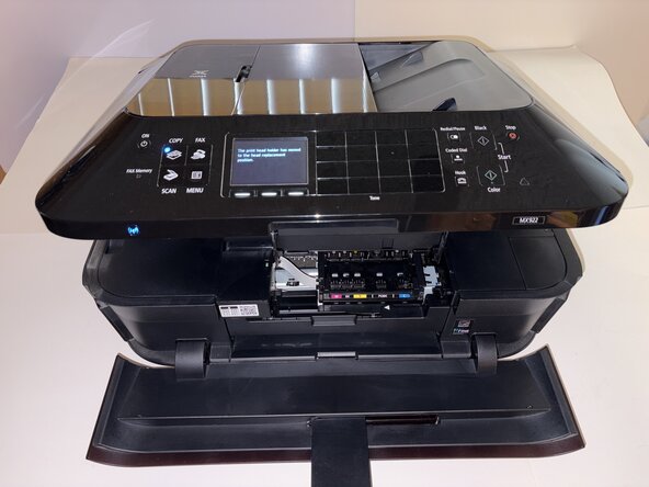

    7. Canon PIXMA MX922 Printhead Replacement: step 7, image 1 of 3 Canon PIXMA MX922 Printhead Replacement: step 7, image 2 of 3 Canon PIXMA MX922 Printhead Replacement: step 7, image 3 of 3
      • Press and hold the stop button until the print holder stops. The holder should move to the right and towards the center.

    8. Canon PIXMA MX922 Printhead Replacement: step 8, image 1 of 3 Canon PIXMA MX922 Printhead Replacement: step 8, image 2 of 3 Canon PIXMA MX922 Printhead Replacement: step 8, image 3 of 3
      • Pull the holder towards the front until it is above the edge.

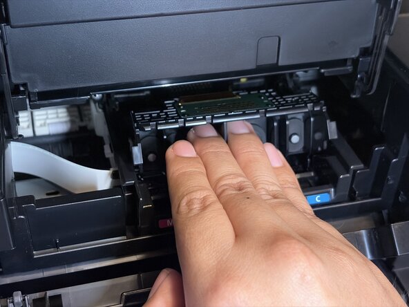

    9. Canon PIXMA MX922 Printhead Replacement: step 9, image 1 of 3 Canon PIXMA MX922 Printhead Replacement: step 9, image 2 of 3 Canon PIXMA MX922 Printhead Replacement: step 9, image 3 of 3
      • Use your finger tips to grab the top of the middle tab which will release the printer head.

    10. Canon PIXMA MX922 Printhead Replacement: step 10, image 1 of 3 Canon PIXMA MX922 Printhead Replacement: step 10, image 2 of 3 Canon PIXMA MX922 Printhead Replacement: step 10, image 3 of 3
      • After releasing the printer head, pull the printer head out of the printer. The new printer head can now be slid into the printer.
