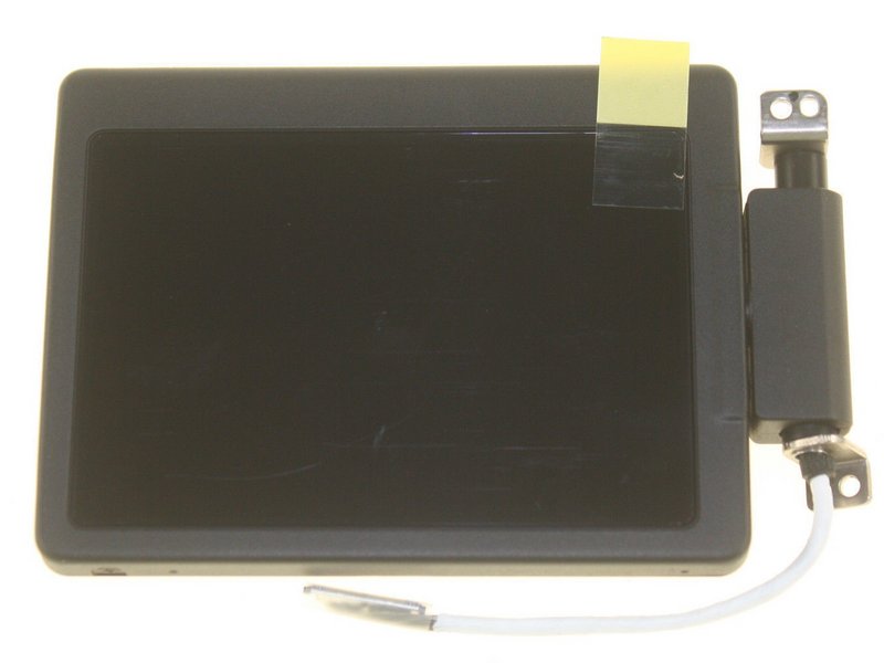

Where can I purchase the LCD screen assembly?
Fred Noce - Reply Share
I know this post is over two years old but I purchased mine from Aliexpress
Mark - Reply Share
