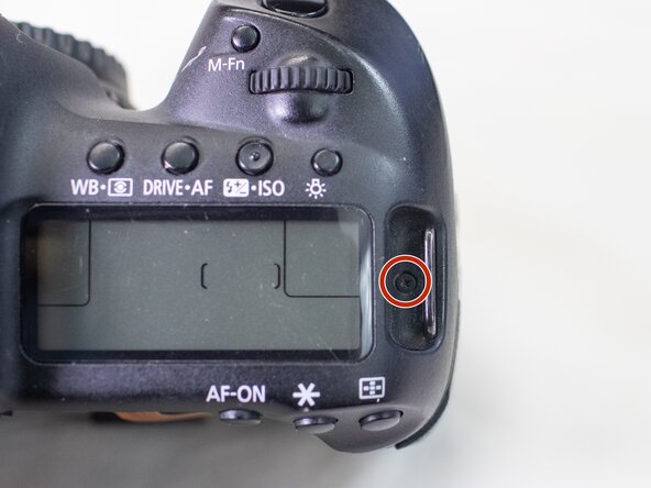

    • Before beginning, remove the battery and SD card from the camera.
    • Remove the eyepiece.
    • Using a pair of tweezers, unclip each side of the eyepiece from the bottom while providing light pressure upwards on the eyepiece with your thumb.

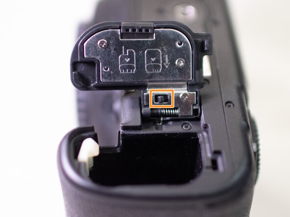

    • Remove the battery door.
    • Open the battery door and disengage the hinge spring.
    • While holding the spring back, pull off the battery door.

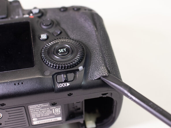

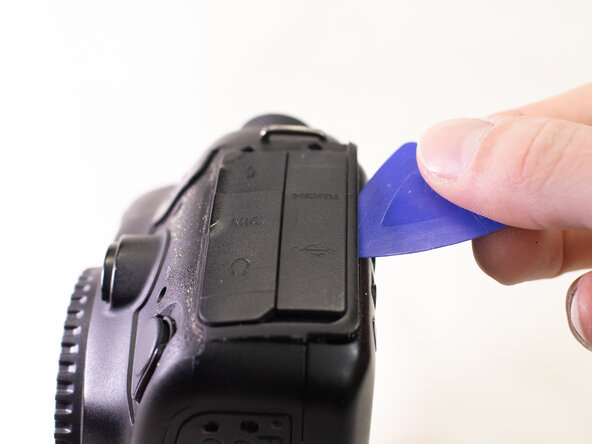

    • Using a plastic spudger tool, peel off the rubber grip on the left side of the camera.

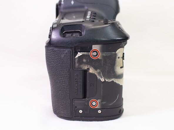

    • On the Left side of the camera, underneath where the rubber grip was, remove the following screws:
    • Two M1.7x5.0mm Phillips #000 screws.
    • One M1.7x5.0mm Phillips #000 screw.
    • Pry off the plastic interface cover.
    • Use a plastic opening tool if a fingernail doesn't work.

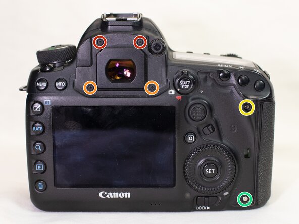

  3. Canon EOS 5D Mark IV Shutter Dial Replacement, Back Cover: step 3, image 1 of 2 Canon EOS 5D Mark IV Shutter Dial Replacement, Back Cover: step 3, image 2 of 2
    • With a plastic spudger tool, peel off the rubber grip on the backside of the camera.
    • On the backside of the camera, remove the following screws:
    • Two M1.7x4.5mm JIS #000 screws.
    • Two M1.7x6.0mm JIS #000 screws.
    • One M1.7x9.0 JIS #000 screw.
    • One M1.7x4.5mm Phillips #000 screw.

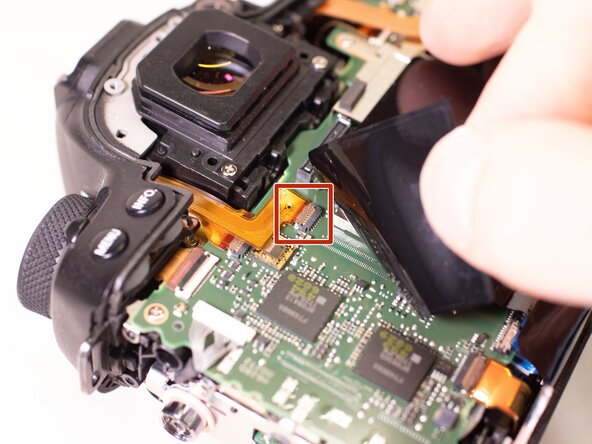

    • Slightly lift up the back cover from the camera, using a plastic spudger or opening tool as needed.
    • Be very careful when lifting the back cover up, there are still two fragile cables attached to it.
    • Carefully pry up the ribbon cable attaching the screen to the main PCB board using a plastic spudger.
    • With the cable disconnected, you can finish lifting off the back cover from the camera.
