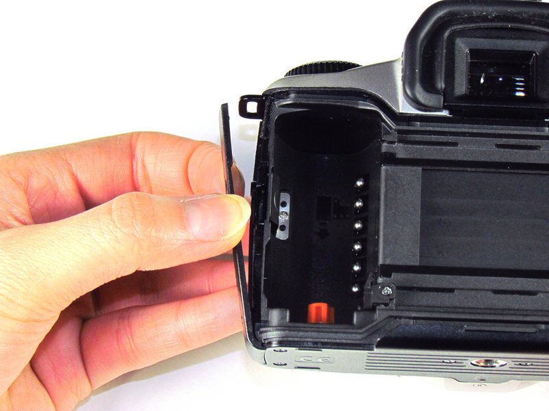

This guide removes the side panel of the camera, allowing for repairs on the side lever.

    1. Canon EOS 300 Side Panel with Lever Replacement, Batteries: step 1, image 1 of 3 Canon EOS 300 Side Panel with Lever Replacement, Batteries: step 1, image 2 of 3 Canon EOS 300 Side Panel with Lever Replacement, Batteries: step 1, image 3 of 3
      • Open up the battery door.
      Ask FixBot
    2. Canon EOS 300 Side Panel with Lever Replacement: step 2, image 1 of 2 Canon EOS 300 Side Panel with Lever Replacement: step 2, image 2 of 2
      • Remove the batteries from the camera by sliding them out into your palm.
      Ask FixBot
    1. Canon EOS 300 Side Panel with Lever Replacement, Side Panel with Lever: step 3, image 1 of 2 Canon EOS 300 Side Panel with Lever Replacement, Side Panel with Lever: step 3, image 2 of 2
      • Release the side latch to open the back panel.
      Ask FixBot
    2. Canon EOS 300 Side Panel with Lever Replacement: step 4, image 1 of 2 Canon EOS 300 Side Panel with Lever Replacement: step 4, image 2 of 2
      • Remove the two black 4.5mm screws above and below the latch.
      Ask FixBot
    3. Canon EOS 300 Side Panel with Lever Replacement: step 5, image 1 of 2 Canon EOS 300 Side Panel with Lever Replacement: step 5, image 2 of 2
      • Using your finger, carefully pry open the side panel from the top of camera.
      • Pull panel downwards to remove.
      • Make sure to keep track of the small black piece of rubber under the latch.
      Ask FixBot
