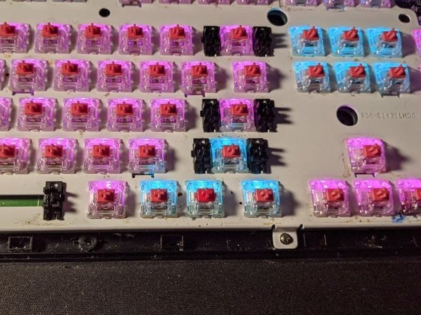

      • This is most effectively done with a key cap puller. However you can also use an IFIXIT opening tool.
      • The IFIXIT opening tool is especially useful in removing the brightness adjuster and windows lock in the top right of the keyboard.

    6. CORSAIR Strafe Mechanical Keyboard Switch Replacement, Separation and Locating Broken Switch: step 6, image 1 of 2 CORSAIR Strafe Mechanical Keyboard Switch Replacement, Separation and Locating Broken Switch: step 6, image 2 of 2
      • Flowing the disconnection of the daughterboard cables pcb unit can now be removed.
      • The next vital step is to locate the soldering joints connected to your broken switch. This is best done with a magnifying device as the identification numbers can be hard to read. In this case the broken switch is labeled "app"
      • From the keyboards that I have done in the past labeling on the pcb is generally pretty good. It is either done in short hand or by numbers.

    7. CORSAIR Strafe Mechanical Keyboard Switch Replacement, Soldering Setup: step 7, image 1 of 3 CORSAIR Strafe Mechanical Keyboard Switch Replacement, Soldering Setup: step 7, image 2 of 3 CORSAIR Strafe Mechanical Keyboard Switch Replacement, Soldering Setup: step 7, image 3 of 3
      • Soldering Iron: 370 Celsius
      • Solder: Rosin Core
      • Fume Extractor: 120mm fan
      • Wick: copper wire coated with rosin flux
      Ask FixBot
    8. CORSAIR Strafe Mechanical Keyboard Switch Replacement: step 8, image 1 of 3 CORSAIR Strafe Mechanical Keyboard Switch Replacement: step 8, image 2 of 3 CORSAIR Strafe Mechanical Keyboard Switch Replacement: step 8, image 3 of 3
      • This step involves a very hot soldering iron relatively close to you fingers.
      • To remove the old solder place the wick over the solder joint and heat with soldering iron. You might have to press relatively hard.
      • Once the majority of the old solder is removed use the tip of the soldering iron to poke a hole through the wick into the solder joint to clear it out completely.
      Ask FixBot
    9. CORSAIR Strafe Mechanical Keyboard Switch Replacement: step 9, image 1 of 3 CORSAIR Strafe Mechanical Keyboard Switch Replacement: step 9, image 2 of 3 CORSAIR Strafe Mechanical Keyboard Switch Replacement: step 9, image 3 of 3
      • The new switch can only be placed in one direction do to the orientation of the leads.
      • As we have flux infused solder we do not need to use extra flux as well. Though I note this because it is much better to have it if your solder is not infused.
      • When soldering make sure not to hold the soldering iron for too long on the now component as this can cause damage.
      • Tinning the tip, can be done by rubbing solder on the tip of the iron and then using the cleaning sponge to help remove and solder residue. This helps make cleaner joints.

    10. CORSAIR Strafe Mechanical Keyboard Switch Replacement, Testing The Soldering Joint: step 10, image 1 of 1
      • To make sure that you solder joint is correctly connected you can use a multimeter to test the continuity.
