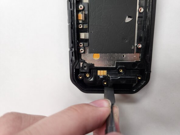

    1. CAT S22 Flip Speaker Replacement, Speaker: step 11, image 1 of 1
      • After heating up the IOpener, use it to soften the adhesive around the speaker.
      Ask FixBot
    2. CAT S22 Flip Speaker Replacement: step 12, image 1 of 3 CAT S22 Flip Speaker Replacement: step 12, image 2 of 3 CAT S22 Flip Speaker Replacement: step 12, image 3 of 3
      • Use the metal spudger and quickly wedge out the speaker from the phone before it cools.
      Ask FixBot
