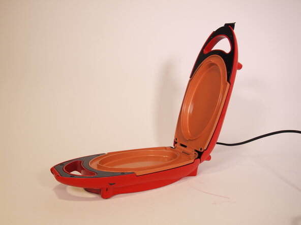

BulbHead Red Copper 5 Minute Chef Disassembly
    1. BulbHead Red Copper 5 Minute Chef Disassembly, BulbHead Red Copper 5 Minute Chef: step 1, image 1 of 1
      • Open the 5 Minute Chef.
      • Remove the two 11.9 mm screws from the black plastic piece using a Phillips #1 screwdriver.
      • Remove the two 10 mm screws from the black plastic piece using a Phillips #1 screwdriver.
      • Repeat this for the other half of the machine; this step is the same for the top and bottom half.
